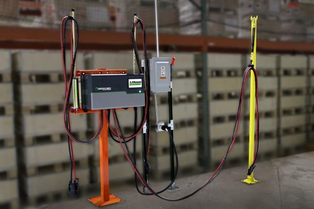

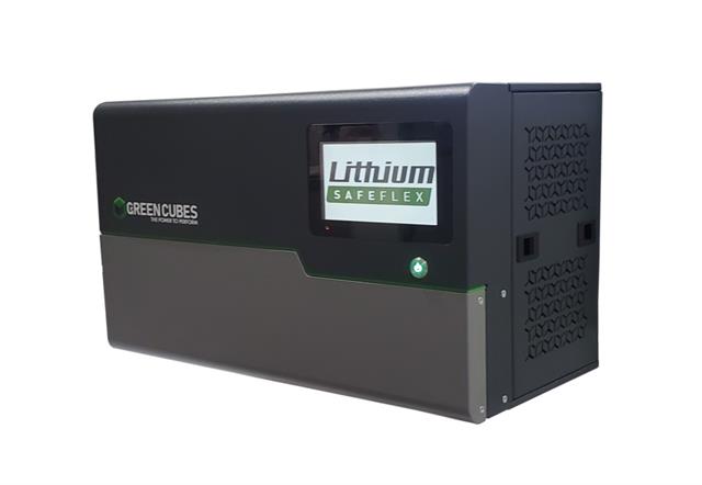

The Lithium SafeFlex Battery Charger is designed to operate with Material Handling (MH) and Ground Support Equipment (GSE) Lithium-ion batteries. This charger has universal AC power input, supports full Level 3 charging via a CANBus communications with the battery, has a touchscreen display, provides unity power factor with very low iTHD which results  in very high charging efficiency, and has the smallest footprint in the MH and GSE charger industry.
This charger is offered in 15 KiloWatt (kW) and 30 kW models. Each model supports up to three simultaneous charging ports, and performs voltage auto-detect for each of the charging ports. This charger is scalable down to 5 kW and up to 30 kW, while each module has a default power level of 15 kW.
This charger supports local and remote management with an embedded Internet of Things (IoT) processor which provides real-time performance information of each charge session with a Lithium-ion battery. Local support and remote administrative staff can review and manage charger/truck integration and overall fleet performance. Access to the Internet is supported via an Ethernet port, WiFi communications, or GSM cellular communications via Sim card slot.
With this charger connected to our Maestro cloud-based applications, fleet managers can monitor all critical charging performance parameters such as voltage, temperature, charge/ discharge current, charge time connected to the battery, Kilo- Watts delivered per charge session and warnings errors.
