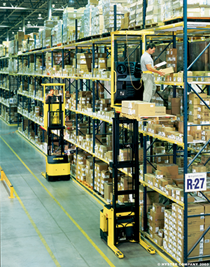

1. Operating at more than 1 metre from the ground
If operating at more than 1 metre from the ground, the machine must be lowered to 600mm or lower before moving forward or reversing to the next location. This is important as the stability of the load at height may be affected when moving.
The machine must then come to a stop before being raised to the desired working height again. All order pickers are fitted with limit switches to prevent them from driving at height. These switches must never be tampered with.
2. Safe travel height
The machine must come to a stop before being raised
The order picker must be lowered to a safe travel height before turning a corner or exiting an aisle. A safe travel height is clear of the ground but below axle height. This will ensure the order picker does not tip over.
