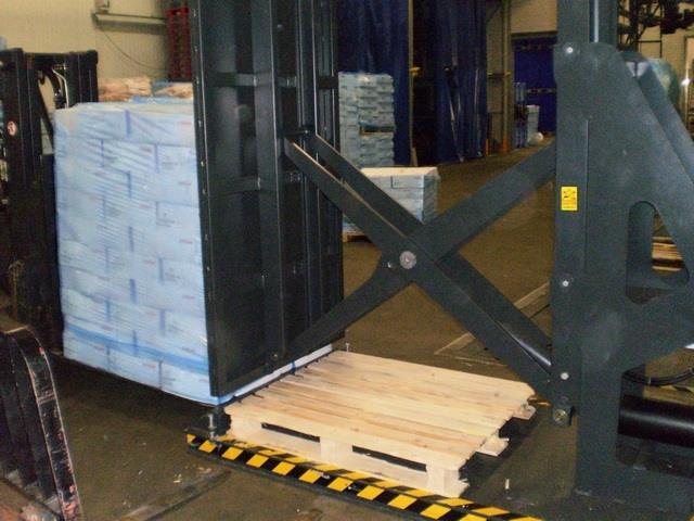

Griptech/MSE-Forks came up with the following system in partnership with Vriesoord:

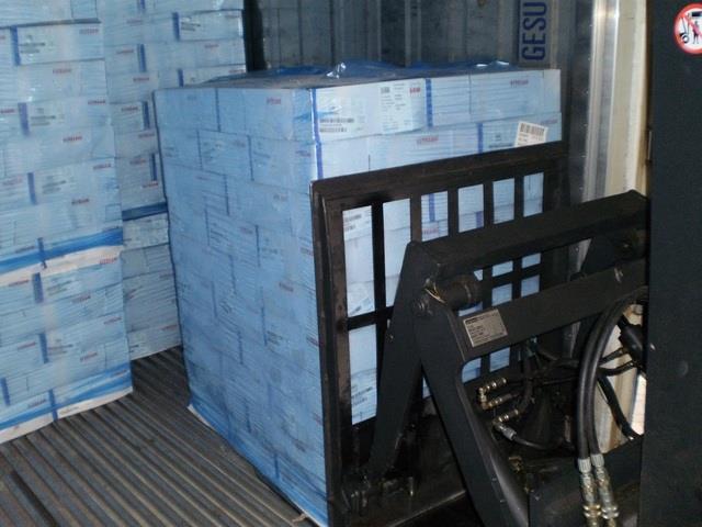

Two forklift trucks are used whereby one truck (A) delivers pallets with frozen goods and the other truck (B) is fitted with a push plate that manoeuvres palletless loads into the refrigerated containers.
Pallets with frozen meat weighing up to 1,600 kg are placed in the mobile load-shifter's drop-off section by forklift truck A. Truck A is fitted with standard forks and a side-shift mechanism.
Truck B is fitted with a push plate that places its push mechanism support plate onto the mobile load-shifter's ledge behind the load. The mobile load-shifters push plate is actuated wirelessly from Truck B by infrared signal. The load is then pushed off the pallet, as the pallet is being restrained. This shifts the load onto Truck B's shift mechanism support plate. Truck B then
manoeuvres the load into the refrigerated container and pushes the load off its support plate.
The mobile load-shifter is equipped with a remote control unit and its own hydraulic power supply.
