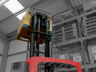

Handling raised loads

Turning with an elevated load
Turning with an elevated load is often a contributor towards tip-overs because turning at the same time as raising or lowering a load causes greater force to be applied to one side of the truck than the other, reducing stability. Laden trucks also become less stable the higher the load is lifted, so adding an additional manoeuvre at this point can only reduce stability further. Though turning with an elevated load is often perceived as a time saver, the delays, costs and consequences of a tip-over far outweigh any minor gains to be made.
To reduce risk:
  • Carry out one operation at a time — eg. pick up the load, reverse, lower it to a safe position, then turn and drive away
  • Ensure operators understand that perceived time-saving measures are not worth the risk of an accident
