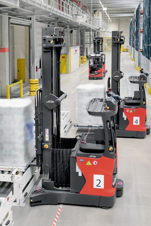

In an age of mounting competitive pressures and an ever-greater lack of skilled staff, automation is frequently the best answer - especially when it comes to repetitive, simple or less ergonomic logistics tasks in warehouses. And there is more good news: Contrary to what is often assumed, automation does not necessarily entail huge capital outlay and science-fiction-esque warehouse environments. Many successful projects start off relatively small, with the introduction of just one or two devices - but with a big impact on efficiency. And this also applies to small and medium-sized enterprises.
When it comes to warehouse automation there is a solution for nearly every need: it could be automated guided vehicles for moving goods from one floor position to another, or between conveyor belts or production lines and floor positions. However, before the project implementation can be started, some important requirements must be met.

If the right mindset is assured and all organizational issues clarified, then it is time to move on to detailed infrastructure planning. Lighting in warehouses needs close examination prior to automation because AGVs often navigate by means of "seeing" physical structures in their surroundings. If AGVs rely on optical sensors, then poor lighting can blindside them. Consideration has to be given to the time of day, the seasons, and incidental sunlight through windows. The flooring is another factor. For AGVs to move swiftly and reliably through any facility, they need smooth, flat ground. This means rectifying any bumps or unevenness in advance to ensure the seamless flow of traffic. Further obstacles include steep inclines and extremely slippery floor coverings that might cause an AGV to slide off course when starting, accelerating or braking. Another key requirement is a powerful warehouse management system and an intelligent material flow control solution. In addition to ensuring the smooth movement of goods, these also deliver the information and transparency that are vital to an automated facility. The data enables all core processes to be accurately modelled and seamlessly managed. Finally, the deployment of AGVs requires a reliable, stable and broadband WLAN (Wi-Fi) interface. After all, the vehicles need to continue operating during the lunch break while employees intensively use their smartphones. Because AGVs continuously communicate with each other and the central control software via the local Wi-Fi network it is in many cases advisable to establish a separate, dedicated network just for AGV communications.
