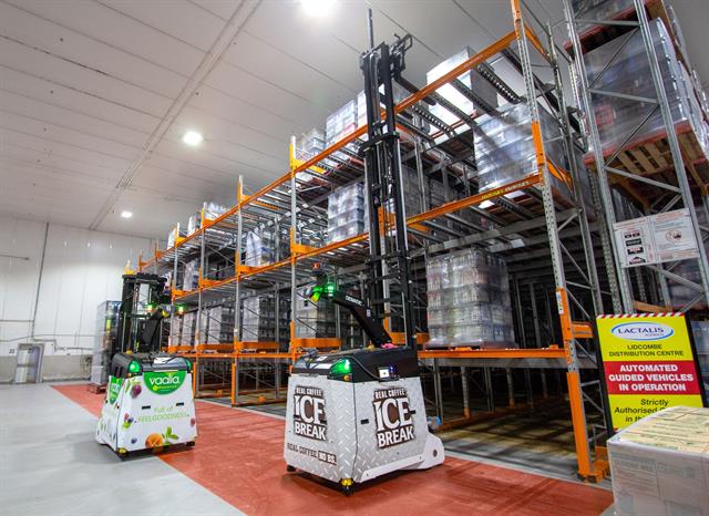

The AGV solution chosen by Lactalis, Dematic's Counterbalance Series AGV, manages the transportation of pallets of milk at the Lidcombe site and is capable of lifting loads of up to 1.2 T to a height of six metres. The AGVs are well suited to working at the site, which is a chilled environment that has a temperature of 2 to 4 degrees Celsius.
Four AGVs work to retrieve pallets from an inbound conveyer system from production, and then feed the pallets into an order buffer, releasing the pallets at a declined angle onto pallet live storage racking. They operate in a small space and manage tight traffic at high speeds of up to 1.7 m/s.
The AGV solution's accuracy and safety around workers and any obstacles is ensured through sensors and laser scanners that help them navigate with precision. The AGVs are powered by lithium-ion batteries and can drive themselves onto charging floor plates at times of inactivity and be fully charged in two hours.
