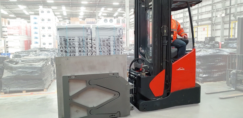

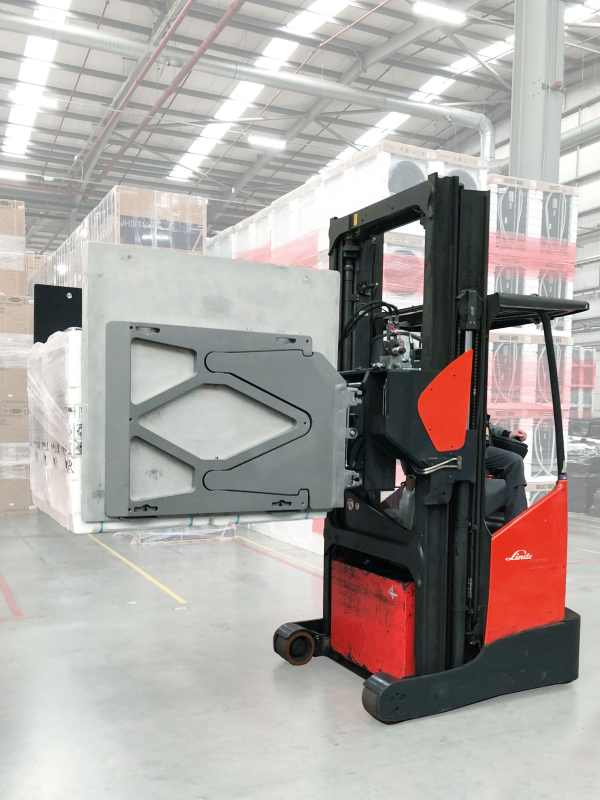

Another first for the general public: the redesigned T414B series appliance clamp. With this product family, KAUP has turned several design screws, because the following requirements were in the specifications for the developers: stability, speed, visibility, sustainability and durability as well as ease of service and maintenance.

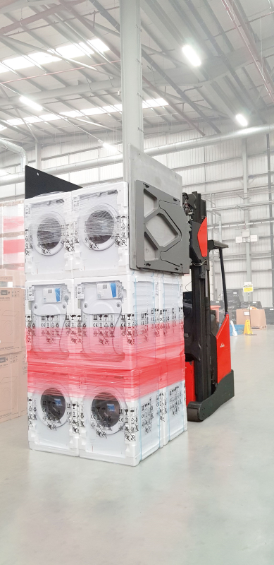

One main application of the KAUP appliance clamp T414B: Handling of white goods.
The arm connection - i.e. the connection of pressure frame and carriage - has been changed for greater stability. The pressure frame itself has also been redesigned. Its modular form is now significantly more compact and it consists of fewer individual parts. An integral part of the revised pressure plates is the new coating: grooved profile rubber. It is particularly abrasion-resistant and is vulcanised directly onto the support plate. Advantage of the new modular design: In the event of one-sided wear of the coating, it will no longer be necessary to replace it completely in the future. Changing the sides of the clamping arms - without removing the entire carriage - including a 180� rotation extends the service life. Additional wear pads on the bottom of the pressure plate also have a prolonging effect. They protect the bottom side of the arm and can be easily replaced after wear has occurred.
But the 2020 generation of the KAUP appliance clamp is not only more stable, low-maintenance and easy to service. It also has a better view for the driver. This is because KAUP uses more fixed pipes in the new appliance clamps than its predecessor. And that benefits visibility.

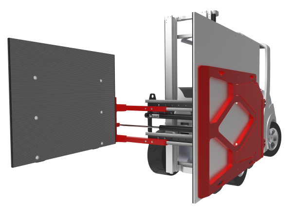

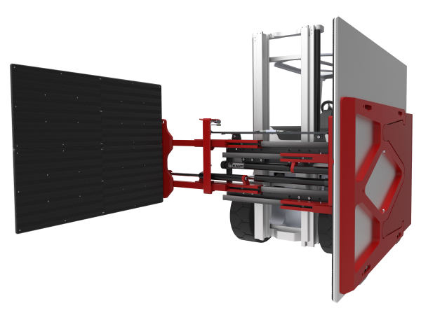

The clamping arms of KAUP appliance clamps have defined preload and a preset camber. KAUP provides two optional extras for the 2020 generation to adjust the mentioned factors so that preload and camber can be adapted even better to the respective goods to be transported. They allow independent adjustment of camber and preload on site. Simple tools are sufficient.
