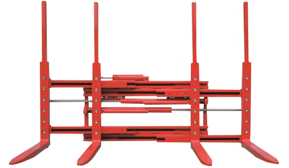

The new Profile Guided Pallet Handler stands out in many aspects: the chassis and arm design underwent an extremely demanding cycle test with a load twice the nominal capacity that it is designed for. "We stopped after we surpassed 1 Million cycles because, the unit simply didn't show any defects so, we are very confident we are presenting an extremely robust design - no other products that underwent exactly the same test procedure achieved comparable results" Ingmar Grabbe Product Manager Beverage Logistics at MEYER GmbH, proudly explains. Next to its robustness the new design embodies the typical product advantages that MEYER Pallet Handlers are well appreciated for: cleanliness in operation, fast operation speed with equal forks travel, and an optimum of visibility on all operation levels.

The new MEYER profile guided Multiple Pallet Handler
The new MEYER Profile Guided Pallet Handler is fully designed around the concept of optimized Total Cost of Ownership by a minimized number of wear parts, long life wearing components, minimized maintenance requirements with reduced labour time.
