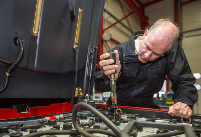

TruckLOG TK5 is one of the most advanced driver access control and fleet management systems available and gives a new perspective on battery monitoring. Misuse of batteries in forklift trucks is a very common occurrence within both small and large operating areas and can cost thousands in replacement batteries. Batteries are consumable items, and often costs are hidden, but they are also one of the most crucial components of a forklift truck. Ensuring batteries are used correctly, such as charging at the right time and not running them too low, can instantly increase the lifespan of batteries
and ultimately saving costs.
The main contributors to why battery life is often shortened within the forklift truck operation are:
  • Early Charging: if a battery is put on charge too soon and before the manufacturers recommended charge level, usually above 25%
  • Late Charging: when a battery has run below the manufacturers recommended charge level.
  • Early Picks: when a battery is taken off charge before battery has reached 100%.
  • Drivers: one of the main reasons batteries are not used effectively is that drivers are not aware or trained to maximise the efficiency of batteries in their forklifts.
TruckLOG TK5 has developed a battery monitoring system that allows managers to see how effectively batteries are being used. The data provided can follow the full history of a battery and also identify which drivers may be causing a problem. Once a driver has been identified then it is possible to offer further training in battery management before they are authorised to operate a forklift again.
The monitoring of each battery's detail can help to control both costs and driver efficiency straight away before any long-term damage has been done.
