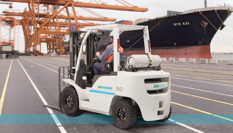

Don Domberg, vice-president of aftermarket and customer satisfaction for UniCarriers Americas, says a practice he regularly sees is forklift operators attempting to operate the forklift before being properly seated behind the controls. He says this - and not wearing a seatbelt - are entrenched driver behaviours which UniCarriers addresses through its Enhanced Seat-Actuated Operator Presence System. The simple system requires the operator to be seated for the major forklift systems to function. The system disengages the forward/reverse transmission solenoids within three seconds to prevent further forklift movement.

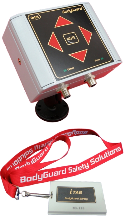

According to HSE 2010/11 statistics, 57% of forklift injuries occur as a result of being struck by a moving vehicle. In the USA, it is estimated by ITA to be closer to 80%. Australian company Orbit Communications has developed the BodyGuard i-Tag to reduce the risk of collision between moving vehicles and pedestrians in the workplace. David Huisman, director of Orbit, says that he sees non-compliance of personnel with safety processes around moving vehicles as a significant issue in the workplace. The BodyGuard i-Ttag works by setting up a programmable exclusion zone around the forklift. It then provides an audible and visual alert to the forklift driver when a person/object is detected in the zone. An optional vibration alert (personal tag device) which can be worn by pedestrians is also available. Importantly, the personal i-Tag can be detected through the body and most solid objects, ensuring protection from behind or through palleting. Because the tags will activate any BodyGuard i-Tag system when they are detected within the exclusion zone, the system will work on any site or location without the need for reprogramming or changes to be made.

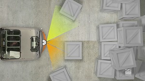

Giacomo Mezzera, marketing manager for Italian company Cy-Pag Srl sees lack of visibility and driver distraction as common causes of forklift accidents. Cy-Pag's SIS collision-avoidance system prevents and avoids the risk of collision by slowing the forklift down and blocking movement in two critical situations - reversing and load lifting. In an imminent collision, visual and acoustic warnings are triggered by a compact ultrasonic sensor discreetly mounted in the forklift's cab. Cy-Pag is also developing a stand-alone system positioned onsite which detects the approach of forklifts at designated meeting points or junctions. The system alerts pedestrians as well as forklift operators via flashing lights and audio alarms.

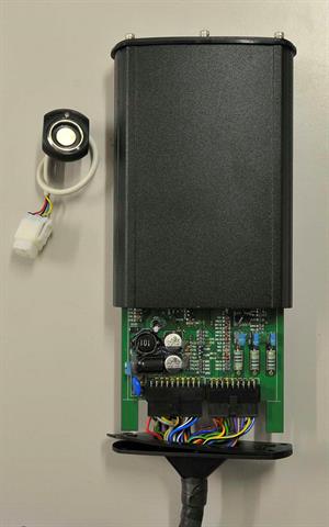

John Valentine, director of Real Telematics, a South African-based company, knows all too well how difficult it is to change entrenched driver behaviours. "'Formula Forklift' is real," says Valentine. "The truth is that races between forklift drivers do take place. I have seen camera footage of forklifts lining up and taking off at wheel-spinning speeds. Pallet trucks apparently have a race all of their own - it's called 'formula donut'!" The ramifications of this behaviour are serious, which is why Real Telematics has designed Real FMX, an electronic data management system that provides alerts for over-speed events, warns the driver prior to the approval limit and creates a behaviour profile which can limit speeds to the specific application maximum.
"Over time, habits become ingrained; training, management and Real FMX can ensure that these are good rather than bad habits," says Valentine. He adds that many companies and forklift operators believe that limiting speed also limits productivity; however, Real Telematics' studies show that with correct application and management of hours, productivity can actually improve.

Unicarrier GO4 with enhanced seat-activated presence action
Domberg says that while developed countries call for mandatory training and manufacturers continually develop operator training programs to meet these regulations, developing countries fall well behind. He suggests that manufacturers need to help bring these developing countries' training programs up to the same standards.
