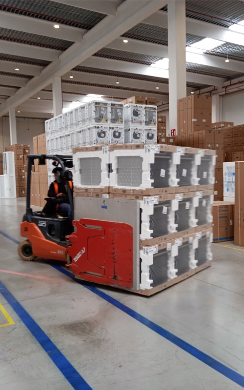

The Easy-FORCE-C clamping force control system is the ideal solution for white goods handling. Especially when it comes to logistic centers where different load volumes require different clamping pressures.
Easy-FORCE-C: the right clamping pressure for your load configuration
Bolzoni has set a new milestone in the white goods material handling. This new Bolzoni Auramo system is a great tool to help the forklift truck driver, to select the correct clamping pressure according to the load to be handled. Through various levels of selection, on the touch screen monitor fitted in the driver cabin, the operator enters the load type and load configuration and with a simple touch of display the device sets the correct clamping pressure. The handling can now proceed in a simple and fast way.

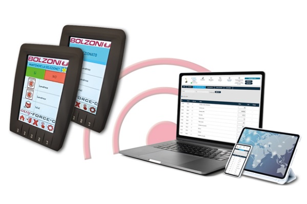

More simple and intuitive interface

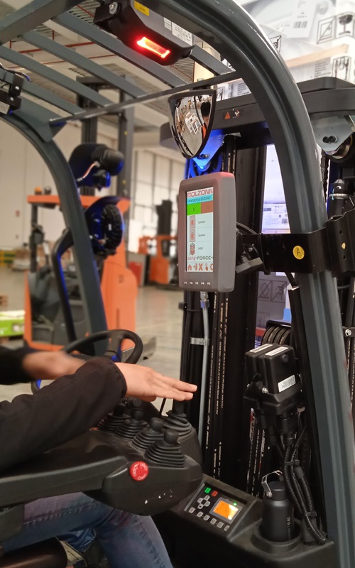

Thanks to the 7" touchscreen display, the operator sets the type of load to be handled with a few simple touches: select the product category (washing machines or refrigerators, for example), the type of product in the specific and the load configuration.
Once these three simple steps have been carried out, the system automatically sets the correct clamping pressure and confirms to the truck driver with a simple message on the display that the pressure has been limited.
Handling repeatability and data customization
Once a handling operation is finished, the configuration is saved and can be re-selected with a simple click, without having to re-enter the parameters. This is very useful especially in logistic centers where recurring cargo compositions are moved.
Frequently used and history configurations are automatically saved by the system, moreover favourites configurations can be saved and are visible on the cabin display, in order to be quickly re-selected by the driver.
Clear layout, optimum visibility, this system is simple and intuitive to use: the icons allow to quickly select the characteristics of the load configuration to be handled.
To ensure maximum efficiency this system is equipped with Wi-Fi connection. This allows to store data clamp records and pressure details in a dedicated webserver.
Furthermore, operation details can be customized at a later time on the web platform. Load dimensions, weight and possible handling configurations are uploaded in the system and matched with a defined clamping force. Load data can be changed and updated in the system and are directly updated on the cabin display.

Closed loop safe handling
To facilitate the driver, and to significantly reduce the risk of load damage due to possible incorrect clamping pressure, Easy-FORCE-C has been designed with a closed loop system. The proportional valve is controlled by the system that continuously sample the hydraulic pressure through a dedicated sensor.

The Easy-FORCE C System web platform allows managers to remote access to statistical data via smartphone, tablet or pc.
