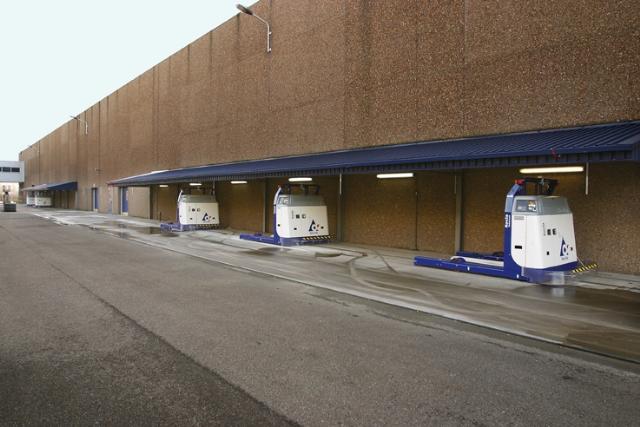

In 2002, when Rocla signed the contract to deliver automated guided vehicles to international packaging giant Tetra Pak, the company completed what was then the biggest AGV deal in its history. The deal included automation of seven factories and delivery of around a hundred AGV's to factories all over the world. These vehicles have now been in use for just over a decade, and Tetra Pak has decided to upgrade its AGV fleet to meet the demands of a modern production environment. This solution provides the company with a cost-effective means to extend the service life of its AGV system.
'The modernisation project has started at Tetra Pak's factory in Arganda, Spain, where there are 20 AGV's in total. The vehicles are still in good condition externally, but they are in need of an upgrade because spare parts for their control system, for example, are no longer available,' explains Sales Manager Jari Kätkytniemi.

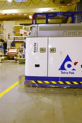

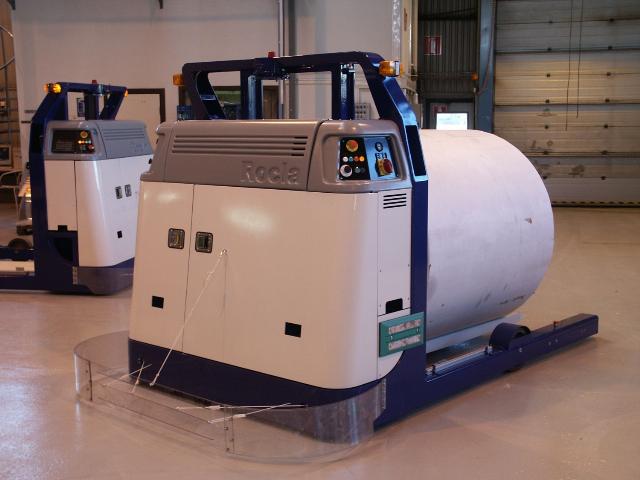

The old system software and control based on ACC70 technology are to be replaced with a modern NDC8 platform. The DC drive motors of the vehicles will also be replaced, with more efficient AC motors.
Occupational health and safety is another important aspect of the modernisation project. Thanks to the modernisation programme, Tetra Pak's vehicles will also meet the stricter safety standards now entering into force.

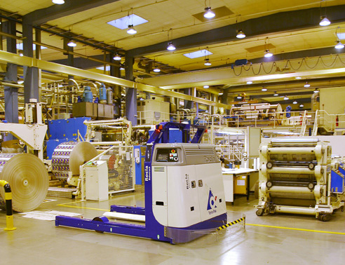

'The modernisation work itself will be carried out at Rocla's Järvenpää factory. The project is being scheduled and planned such that the time the vehicles are out of service can be kept to a minimum,' Kätkytniemi explains.
On-site installation will be completed alongside normal production, one vehicle at a time. Rocla's installation team have designed a bespoke panel-upgrade solution, in which the components to be installed are attached to the new electricity panel. This allows the modernisation work to be completed in a matter of days, or a couple of weeks at most. This solution is possible because all AGV's originally delivered to Tetra Pak are of the same type and model.
