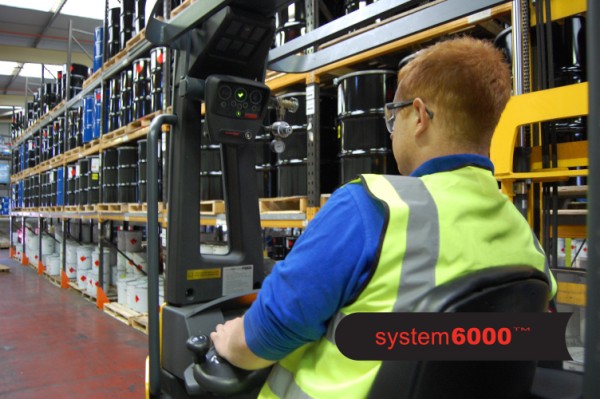

Separately, Pyroban will officially launch a new generation of zone 2 explosion-proof forklift conversions at IMHX 2010 at NEC, Birmingham. System 6000, the new solution for zone 2-classified hazardous areas is suitable for all types of diesel and electric mobile equipment. It incorporates intelligent gas detection to continuously monitor the environment around the protected equipment.
Pyroban's Malcolm Davis says the new system "supersedes" the company's award-winning System 5000 with new software, new hardware and infrared and gas-sensing options.
"Forklift technology has become increasingly complex with a focus on energy consumption and ergonomics. System 6000 complements the latest technologies seen in engine and battery electric truck design, particularly VNA, pallet, picking and reach truck designs," Davis adds.
