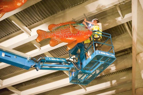

First of all, don't use a forklift to raise people at all if you have another safe way to get the job done. Forklifts are designed as materials handling devices not personnel elevating devices, so if you have a more traditional way to get people into the air like a ladder, scaffold or aerial lift (boomlift, scissor lift, etc.), use it. If you have no other way and must use a forklift, consider the following:
