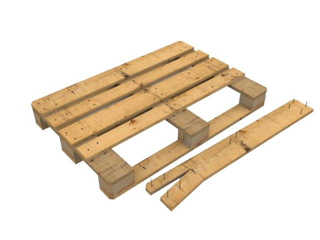

The Europallet is the most widely used pallet in Europe and it is estimated that there are approximately 450 million of them currently in circulation. With a price of around €25.00 per Europallet, the prevention of damage to these pallets is of increasing concern. If you use Europallets in your warehouse, your forklift drivers must be alert to whether they are approaching the pallets on the long or short side. After all, Europallets (EUR-pallet/EPAL) measure 800 mm by 1200 mm. Standard forklift forks are neither 800mm nor 1200mm in length, usually coming in lengths somewhere in between. In all cases, the forks are longer than 800 mm, so when your forklift operators approach pallets from the long side, they must take care that the forks do not protrude on the other side.
KOOI®ReachForks For EUR (EPAL) Pallet Handling
Although we regularly see markings on the forks, these gradually wear away over time. These markings are also difficult to see from the driver’s seat and constant checking slows down the speed at which pallets are handled, and this in turn costs money.

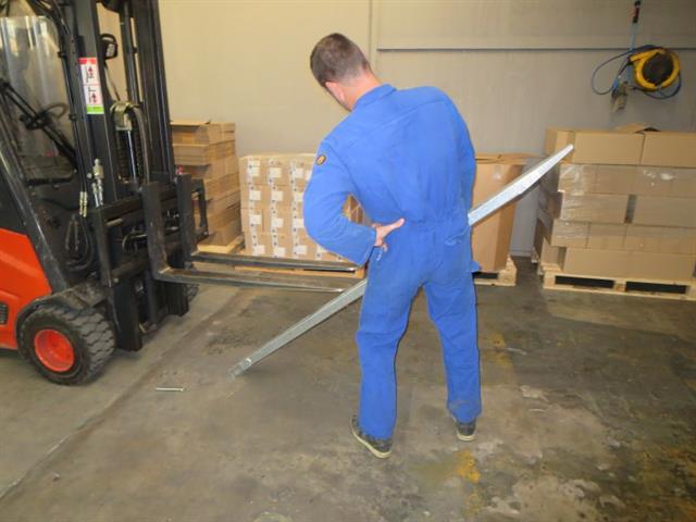

The fact that the operator can remain seated reduces the chances of unsafe situations as there is no chance of being hit by another forklift and no time is lost fitting fork extensions. Fork extensions (see picture) have to be fitted at a different location and are heavy, so lifting them puts a physical strain on the driver and can easily cause back injuries.
