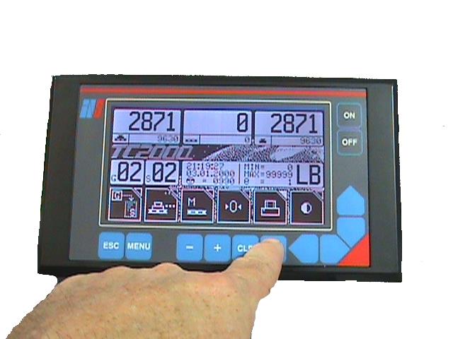

KEYTROLLER'S VANGUARD (World's most accurate hydraulic forklift scale) is designed to provide accuracy to within .2% of the rated load (within 10# in 5,000# load - 4.5kg in 2250kg load).
HOW DOES THE VANGUARD ACHIEVE SUCH HIGH ACCURACY?
Most hydraulic scales weigh statically. The Vanguard scale weighs Dynamically. By weighing Dynamically and utilizing a solenoid controlled hydraulic bypass manifold module. The Vanguard Weighing system eliminates many hydraulic weight errors that are present in other weighing systems. The By Pass Module is mounted behind the mast on the forklift's firewall. When the weighing process is initiated Hydraulic fluid (under pressure from the load) bypasses through the module where the pressure sensor reads about 150 pressure values per second over a 5 second period. As the load slowly lowers about 12 to 14" over the 5 second period. Hundreds of pressure readings are averaged by the device and the Vanguard displays an accurate weight. (Conventional single pressure reading scales are subject to considerable error from-valve opening/closing technique, tilt, lift height, bearing hang-ups, etc.)

The load is raised approximately 2' (60cm) above the ground. Operator presses ENTER button on LCD display and solenoid in bypass module opens. This allows hydraulic fluid under pressure to flow through the bypass module while the forks slowly lower to near the floor. At this point the solenoid closes, forks stop lowering and the driver has his weight on the LCD display. Takes about 5 seconds.

Yes!! VANGUARD has a user friendly interactive LCD screen that makes the device easy to calibrate and operate. The device can log weighing events in up to 99 different channels with up to 99 different weighing events per channel. The 99 channels allow for totalization of all weights for a certain product, customer or trailer that show current load weight and total for all loads on that channel. The top number on the display shows current load on forks, smaller number underneath denotes cumulative weight on that channel.
