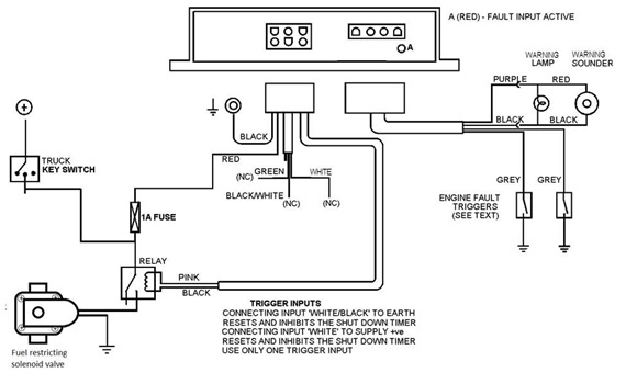

If you do not want to shut the engine down, "crawl mode" option is available. Keytroller's fuel solenoid, when actuated by a low oil pressure or high engine temperature event, will restrict fuel flow, allowing the vehicle to only attain a "crawl" speed. When the ENGINE-SAVER system receives a high engine temp or low oil pressure reading, it will remove the 12VDC supply from the pink and black wire and drop the solenoid - essentially, the solenoid replaces the relay. You can keep the relay and use its contacts to switch the fuel solenoid. The drawing below shows the how the relay could be connected. Cycling the supply to the engine saver will reset it.
