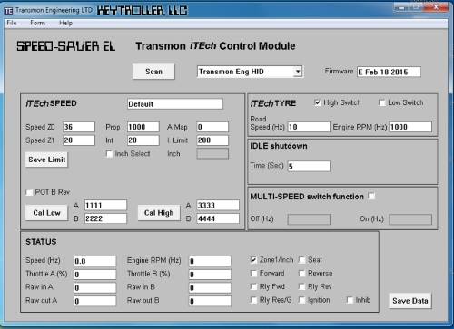

This prevents the driver abusing the truck by changing direction while still in motion, or selecting drive with high engine speed. The programmer sets vehicle speed and engine RPM setpoints in the device via free Windows software via a PC. If the operator changes direction and either the vehicle speed or engine RPM is above the setpoints---then the directional change DOES NOT take place. This forces the operator to apply the breaks to slow the machine and reduce engine RPM. When these setpoints are reached---directional change takes place. The use of the TIRE-SAVER option leads to a considerable decrease in tire wear and increase in tire life (depending on application and driver habits this feature can improve tire life by up to 400%). Besides reducing tire wear, the TIRE-SAVER protects the drive train/transmission from operator abuse by preventing drive unless the road speed and engine revs are below the pre-set limits. With the addition of an inching pedal switch, the clutch pack can also be protected from excessive wear in the same way.

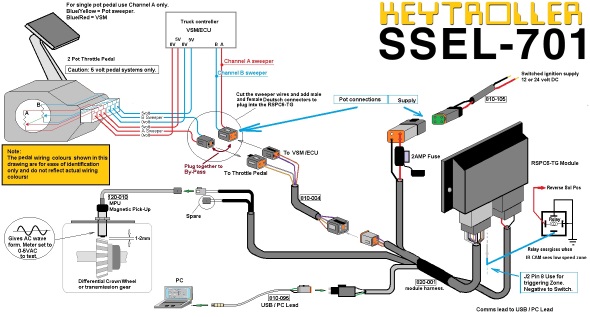

The Control Unit obtains its road speed signal from the gear tooth speed sensor fitted over the crown gear on the drive axle---or the device can obtain the speed pulses from an OEM fitted speed sensor. If the fork lift truck is already fitted with a road speed sensor, dependent on the truck model, it is normally preferable to interface to this signal. When the road speed exceeds the threshold set within the Control Unit the limiter is activated. In this condition the engine output is restricted to provide only sufficient torque to maintain the limited speed, i.e. the road speed is maintained even when driving up a slope, release the pedal to reduce speed.
This generation of digital road speed limiter is pre-configured and is adjusted using our free setting software and Windows PC. Only authorized truck engineers can gain access to the unit's settings. To facilitate the installation and fitting of the SPEED SAVER device---be sure to include your make and model forklift because we offer a number of premade "plug and play" harnesses for many of the fork lift trucks which use drive by wire throttle systems.

SPEED SAVER EL kit comprises the following as core items:
  • The Control Unit.
  • The relevant cable harnesses (if make/model forklift is included with order)
  • Fitting equipment.
  • Installation manual.
  • Software Disc or Stick
  • An itemised list of all the parts supplied
  • In addition to the core items the kit supplied may also include:
    • Magnetic pick up (MPU) speed sensor.
    • Loose Deutsch connectors for fitting to the trucks harness.
    • Mounting brackets for either the MPU or the Control Unit.
    • Bespoke interconnection documentation which could include guidance installation photos and truck specific schematic diagrams.

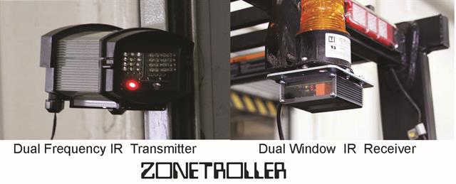

    How the IR ZONETROLLER works:
    Transmitter mounted at boundary sends out two different pulse patterns (restricted zone and unrestricted zone). When the receiver on the vehicle crosses over the IR boundary it picks up the different pulse pattern which causes the device to turn on (or off) an external relay. This relay input actuate high or low speed setting in SPEED-SAVER EL device.
    INFRARED RECEIVER
    1. Connects to vehicle power supply (12VDC) and mounts externally to vehicle. Use voltage converter if mounted to electric vehicles
    2. Receiver reads IR input for OK "safe" zone, when 2nd IR signal is detected it recognizes it's moved to restricted zone--relay actuated
    3. Module drives relay which can:
      Actuate high and/or low speed in the SPEED-SAVER EL device---automatic control of top speed.
    INFRARED TRANSMITTER
    1. Plug in device 12VDC plug in power supply into 110VAC outlet to power transmitter
    2. Mount transmitter over zone boundary (example: over door----inside "safe" zone----outside "restricted" zone)
    3. Device transmits two different IR signals ---one in "safe zone" and a different one in "restricted zone
