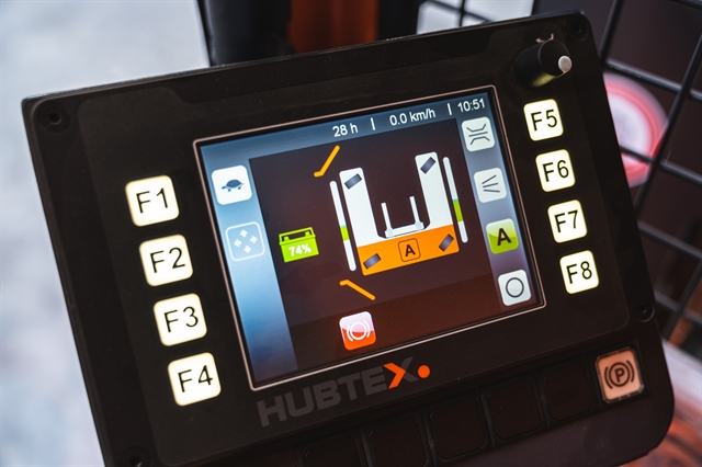

The entrance to the narrow aisle is displayed on the HUBTEX information terminal. After acceptance, the Phoenix automatically steers in front of the aisle entry.
