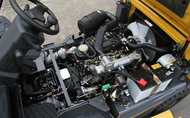

Powerful, economical engines run cleaner and stronger: The upgraded LPG, gasoline, and dual fuel engines meet Tier 3 specification, yet give up nothing in power and economy. They operate cooler because of airflow improvements through the engine compartment. The dual fuel models change from LPG to gasoline and back with just the flip of a switch without any mechanical adjustments. Our diesel models remain legendary for their dependability and power.

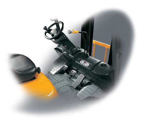

Improve your Operators' productivity: The new TCM PRO Dual Isolation System effectively prevents vibration from reaching the Operator by isolating the engine and drive train from the operator platform. The optional suspension seat is adjustable for position, weight balance, tilt, and incorporates a built-in restraint system. The wide-open floor space has been increased by 45%, and is the largest floor space ever designed into a TCM pneumatic lift truck! The steps are also wider - 55% wider - for easier entry and exit. The instrument cluster monitors all truck functions, and incorporates LCD technology that is easy to read even in bright daylight. The small steering wheel with standard spinner and smooth, precise controls make load handling easy and quick. The dash and mast cross member have been lowered to give a 50% improvement in forward visibility.

Designed for quick, low cost maintenance: Tool-free removable side panels and floorboards give complete access to the mechanical systems. Filters and drains are easy to reach. Control valves and mast connections have been simplified for leak-free operation. TCM brakes are the largest in the industry, and will not overheat even in high cycle operations. On board diagnostics are included for easy troubleshooting. Electrical components, including all relays and the ECM connector are located together in the front of the engine compartment for quick access.
