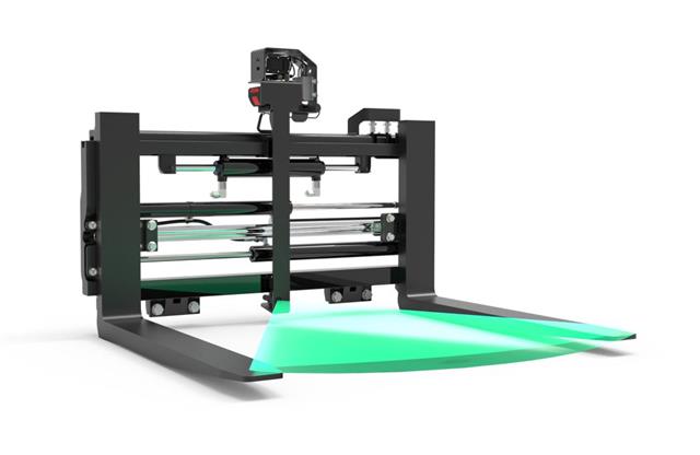

In material handling having a good front view is the basic requirement for safe operations. Especially in logistic warehouses, when it is required to handle pallets on the highest shelves, in particular bulky loads, it is essential to see where the forks are being placed.
BOLZONI has specifically designed a solution to overcome these difficulties: Easy-FORK Vision System with front camera and laser.
Today BOLZONI presents a further option to increase the material handling accuracy, fitting an existing fork positioner with a front camera and laser system.
Thanks to the laser beam and to the front mounted camera, the operator has a clear view of the fork tips and is able to easily pick up the pallet, preventing accidental collisions with possible obstacles.
The Easy-FORK Vision System with laser beam reduces the load damage risk during the pallet picking phase.

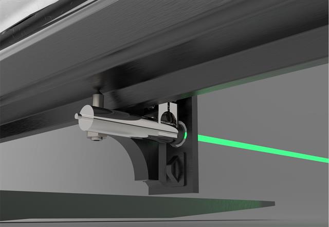

Laser allows the forklift truck driver to conduct more precise maneuvers
The laser, mounted on the frame, projects a horizontal linear beam with an angle of 90 degrees aligned to the points of the forks. This pointing device allows the driver to have the correct reference to precisely place the forks in the pallet pockets, and to also identify the forks encumbrance during maneuvers.
Laser is Radiation Class 1 category according to DIN EN 60825-1, which is safe even for long term intentional view.

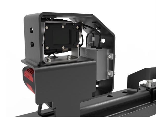

The front mounted camera
The front camera is positioned on top of a central support in a configuration, that allows both camera and laser installation.
Thanks to the camera position, the driver can have a clear view on both fork tips, in the majority of operating conditions, with horizontal 120° view angle and vertical 52° view angle, while maintaining the correct ergonomic position on the seat.
This robust camera is waterproof (IP69K) and highly vibration resistant up to 10 G and 100 G shock resistant.
Furthermore, this light color camera is equipped with 6 IR leds to enable a perfect vision even in low light environments.
Among the Easy-FORK Vision System solutions, the front camera is particularly suitable for side shifting and fork positioning heavy-duty applications.
The high quality front mounted camera is a great help to forklift truck driver during loading and unloading operations, particularly when moving pallets at high levels on shelves.

Main advantages of the front mounted camera and laser
Thanks to the dual information stream provided by the front camera and laser, the operator’s view angle is unobstructed on the working area. Meanwhile the laser allows to place the forks in a quick and effective way.
The BOLZONI intelligent forks range: one solution for more applications
This new application expands the options of Easy-FORK Vision System solutions, a full range of forks with side or tip camera, that allow full frontal visibility even with the load on the fork.
