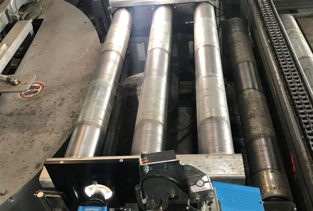

Sick, PACS (PAllet Classification System)
Is it a Euro, a Chep, a UIC or perhaps a completely different pallet? Incorrectly identified pallets can cost companies thousands of euros every year in lot deposits. The PACS application from Sick aims to put an end to this by enabling the automatic deposit of different pallet types.
PACS (an acronym for PAllet[2]  Classification System) is a recognition system that uses images to identify the type of pallet. Four pictures of the pallet feet are necessary for this; the fifth picture is taken from above and shows what is on the pallet. The whole thing is usually integrated into the stationary conveyor system directly in the goods receiving area.
Until now, employees had to manually determine whether a pallet was "good" or "bad" when it entered the factory gate - an additional task that is error-prone and resource-intensive. With the PACS deep-learning pallet identification system, customers are given the opportunity to automate this process with a modular system of hardware and software. The financial aspect is the direct benefit of this classification system. There are other benefits, such as the identification of incorrect or damaged pallets which can also lead to damage and expensive downtime of the conveyor system. The system also creates transparent processes by connecting the goods to the load carrier. And finally, no specialised personnel are required to operate the PACS system.
No programming knowledge is required for PACS because the system learns from concrete examples. In this way, Sick is able to make pallet identification comparatively simple for its customers.
Because Sick uses trained neural networks for its solution, the branding of the individual pallet types can be recognised with a high success rate - even if their quality is subject to large deviations. The training process takes these deviations into account, learns them and thus increases the robust evaluation.
Due to its space-saving design, the PACS system can also be integrated in narrow assembly positions. Because Sick uses standard sensor technology for its solution, the system is very cost-effective to maintain and service.
IFOY Test Verdict
With an estimated 500 million Euro pallets in circulation, not to mention the other types, the savings potential through PACS is in the tens of millions. The application range of the very reliable pallet classification system covers a broad spectrum: retail, freight forwarding, automotive, mechanical engineering and many other industries.
