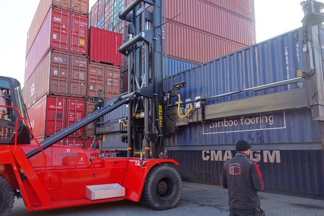

With the Hyster® Checker Device, containers can be firmly locked in place at a height of 1.9 metres. This allows the checker to inspect the containers thoroughly for damage from all sides. The advantage of this is that the container no longer needs to be set down for inspection.

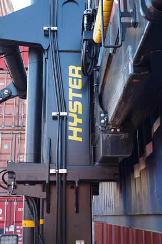

Hydraulic supports help to keep the spreader and the container in place

Hyster first conducted a series of experiments by fitting several machines with the Checker Device for HCS at its big trucks production site in Nijmegen. Hydraulic supports were welded directly onto the mast. These supports can be extended at the touch of a button and then locked to keep both the spreader and the container in place. A traffic light and an acoustic warning signal indicate to the checker that the spreader is fixed and the container stabilised. While in this 'inspection position', the driver can no longer move the container handler, which allows the checker to inspect all sides of the containers with ease.
