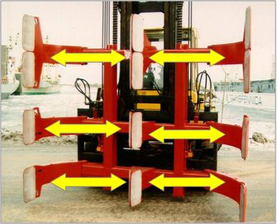

Photos below shows clamps flexibility to adjust according to handled combinations and sizes of paper rolls.
We all know that paper rolls are weaker and most sensitive for damages when clamping on or near to the roll edges. That's one of the reasons why we always recommend split arm clamps.
The optimal solution is to have one contact pad on each paper roll to give a secure grip and to have clamping force on each paper roll to be handled.
When handling with Bolzoni Auramo tower clamp the total clamping forces are divided on six arms/contact pads.
Each roll is to be handled with lowest possible clamping force!
Height of clamp can be adjusted according to number of paper rolls and roll width.

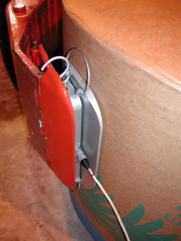

The clamping force in our Tower clamps can easily be controlled with Bolzoni Auramo "Test Pad", an electronic clamping force measuring device. Low weight and easy to handle, this option allows to check the efficient clamping force for each contact pad on a digital display.
