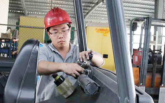

"Diesel trucks are modified so that the operating temperature of the engine is reduced below the required class level," said Shirkie. "A water-cooled jacket cools exhaust gases, and temperature probes are fitted in order to monitor engine, exhaust gas and manifold temperatures."
Heat and fine dust in aluminium smelters can clog up filters.
Pyroban's modifications also include spark arrestors and shutdown valves in order to inhibit ingestion of gases, which can cause overspeed running and potentially generate exhaust flame.
"Once a truck has been modified to meet the necessarily high safety standards, the right maintenance is essential to ensure it stays that way,"" he emphasised. "Any attention by untrained engineers is strongly discouraged as procedures that are not totally compliant can compromise the explosion-proofing in a matter of seconds.""
