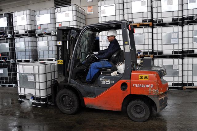

"For more than ten years we have worked with Pyroban to ensure that the forklift trucks used in our Zone 2 areas cannot be the source of an ignition," explains Karel. The trucks are used to transport and store IBCs and palletised drums both inside and outside, load and unload containers, and load conveyor belts in Zone 2 areas.

The two new Toyota FDF30 forklift trucks have been converted by Pyroban with full CE approval in accordance with the ATEX 94/9/EC Directive and EN 1755:2000+A2:2013 standard. There is also written consent from Toyota in line with ISO 3691-1:2011, an important Standard for industrial trucks, safety requirements and verification.

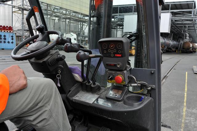

The new trucks feature Pyroban's system6000D, which prevents explosions by combining gas detection with various explosion protection methods. The conversion includes the use of restricted breathing enclosures, stainless steel cladding for forks and surface temperature cooling to T4 (135°C) to ensure the engine, motors, brakes, electrics and other components remain below the auto-ignition temperatures of flammable materials.
The pellistor based gas detection system detects the wide range of potential hazards found in the chemical warehouse at ADPO. It auto-calibrates and self-tests at start up to ensure it is working correctly and the whole solution is certified with gas groups IIA and IIB.
