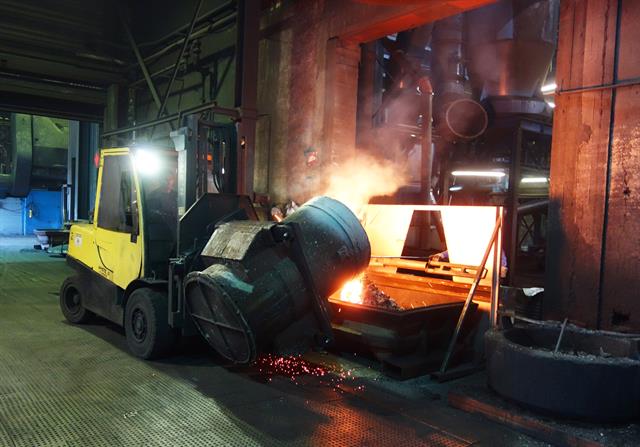

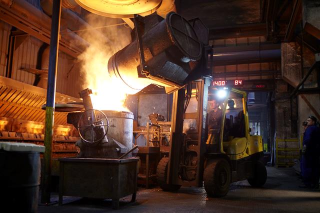

The EWM company site is steeped in tradition and places special demands on logistics. In particular, the company requires powerful and manoeuvrable forklift trucks that are capable of transporting cargo containing hot molten mass, with temperatures of up to 1,400 degrees in the 1.8 tonne ladles around its narrow factory halls.
Today, EWM uses Hyster Fortens H4.0-5.5FT series forklift trucks with a 5.5 tonne lifting capacity and a 600 millimetre load centre of gravity.
"The Hyster forklift trucks are especially manoeuvrable and robust, so they can also withstand the tough operating conditions", EWM Managing Director, Barry Thomas Irvin, explains.

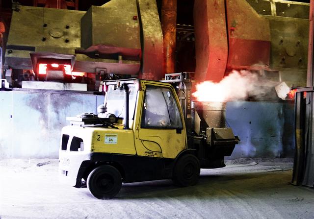

The forklift trucks' DuraMatchTM transmission prevents sudden braking, for example, and controls the direction of travel to ease the load placed on the brakes and tyres. The forklift trucks drive with super-elastic tyres, which are robust enough to also compensate for uneven ground and floor surfaces. Hyster also improved the stability mechanism (HSM) for lateral stability, without compromising the ride on uneven surfaces.
Additional oil cooler and temperature-resistant hydraulics
In order to withstand the high temperatures of the melting furnace, the forklift trucks required to operate in that area are equipped with an additional oil cooler and temperature-resistant hydraulic hoses. Additional filter systems reduce dust accumulation, prolonging the service life. Reduced maintenance and oil-immersed multi-disc brakes also increase the reliability of the Hyster material handling equipment. Special attachments, such as a rotating fork clamp that can handle loads of up to four tonnes, ensure reliable operation. With these special adaptions to the forklift trucks, the hot, molten mass can be transported directly from the oven to the mould casting facility where it is processed. EWM has two ovens, each with a capacity of 16 tonnes that alternately produce 280 tonnes of cast metal daily. This production requires 50 million kilowatt hours of electricity, which is the equivalent of a small town.

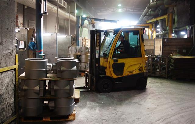

EWM has a fleet of 52 Hyster material handling vehicles. The entire logistics chain - from the delivery of goods and materials to the transport of the molten mass and castings within the plant, on to the loading of the finished parts - is all handled by Hyster forklift trucks. The fleet includes high-lift trucks with and without a platform, Hyster J1.5 -2.0XNT energy-efficient 3 wheel electric counterbalanced trucks with 1.5 to 1.6 tonnes of lifting capacity, Hyster J2.2 -3.5XN compact 4 wheel counterbalanced trucks with 3 to 3.5 tonnes of lifting capacity, and Hyster ICE forklift trucks with 1.6 to 5.5 tonnes of lifting capacity. All the forklift trucks feature a robust and compact chassis design, especially durable and reliable components, as well as low operating costs.
