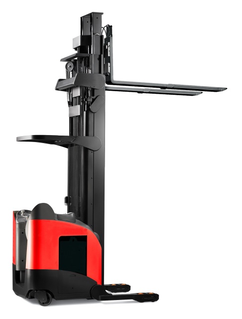

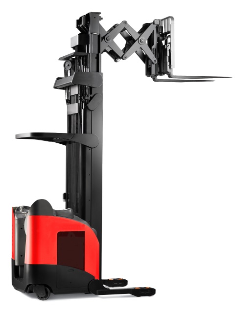

The photos above show similar forklift trucks but each has a different reach mechanism for double-deep storage. The one on the left is equipped with a pantograph, (scissors type), reach system while the one on the right is simply fitted with telescopic KOOI-REACHFORKS®.
Telescopic forks offer distinct advantages when compared to pantograph type reach mechanisms:
  • Lower investment cost
  • Less weight, (due to simplistic design principal)
  • Higher capacity retention, (less mass is extended with the load)
  • Do not hinder visibility for the operator, (improved safety and faster handling cycles)
  • Lower maintenance cost due to absence of rollers, bearings and hinge points
  • Simple mounting and removal, (just like standard forks)
  • Greater versatility, (can also be used as hydraulic fork extensions or for dual load transport)
  • Higher capacity range, (available up to 75,000 lbs.)
  • Do not restrict vertical rack beam spacing, (distance between rack storage levels is governed by load height & clearance only since just the forks telescope out)
Pantograph units may offer an advantage in operations where extremely thin forks are necessary, (i.e. low clearance load carriers), however, this is rarely an issue as MSE-Forks offers KOOI-REACHFORKS® in a special thin series which have a fork thickness of just 40mm/1.6". These thin forks also make it possible to handle North American GMA type pallets through the low profile side-openings.
With the introduction of Single-Range telescopic forks, handling speed, (movement in and out), is equivalent to most pantograph type units. Also, in nearly all cases, any deflection can be compensated using the standard tilt function on the lift truck.
