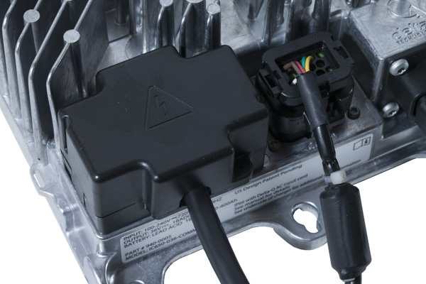

The IC650 Charger "Comm" version supports CAN bus programming, as it has a port for the signaling cable harnesses - Click for larger view.

The IC650 Charger is available in 24V, 36V and 48V models and provides 650 watts of constant DC output power. This power level is appropriate for machines such as walkie pallet trucks (and most other Class 3 electric lift trucks), burden carriers and scissor lifts. "Comm" versions of the IC650 Charger have the necessary communication port to support CAN bus programming.

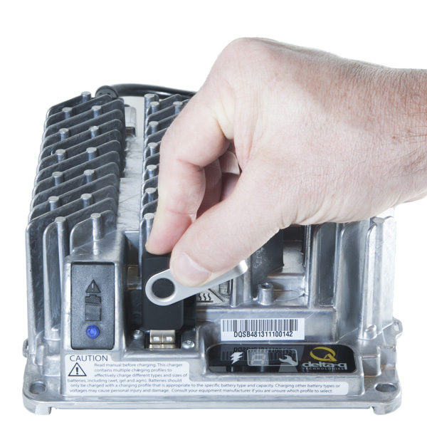

The IC650 Charger has a USB host port, allowing future updates to charger software, charge profiles and CAN bus programming to be implemented by inserting a pre-programmed USB flash drive - Click for larger view.
