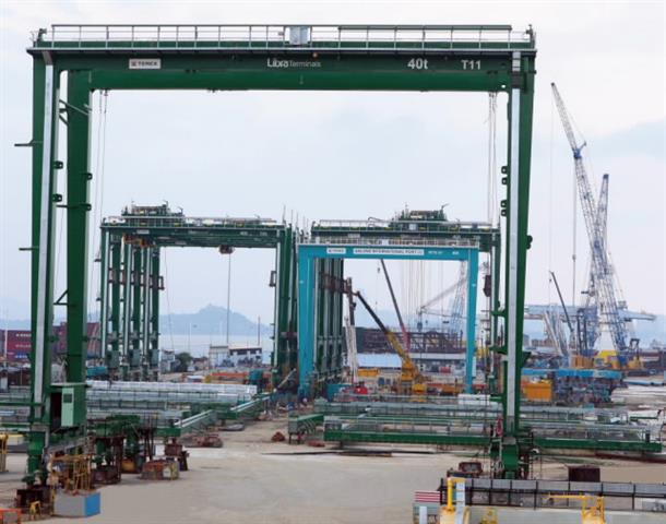

The RTG cranes offer a 40 T lifting capacity and have a hoisting height of 21 m (69 ft.) under the spreader.

The cranes are designed in the Terex E-RTG variant and are powered by electricity from the terminal's electricity supply. The power is fed to the crane via a cable that passes over a cable drum on the crane. According to TPS, their advantage over cranes with a conventional diesel-electric drive is that they do not generate local exhaust emissions and have low noise emissions.
TPS says the energy costs are also substantially lower due to the improved efficiency rating. To enable the cranes to move freely around the terminal for site changes or for maintenance purposes, Libra has also ordered three mobile diesel generators, which can be used in the cranes, if needed, to provide the electricity supply.
The cranes offer a 40 T lifting capacity, have a hoisting height of 21 m (69 ft.) under the spreader and can stack standard containers 1-over-6. They have a span of 26.5 m (87 ft.), allowing them to cover seven rows of containers and a truck lane.
