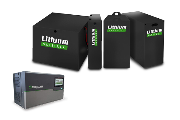

Lithium SAFEFLex batteries and chargers from Green Cubes Technology
About Li-ion Power for Lift Trucks
Technology has replaced the old direct current (DC) electric motors exclusively with modern alternating current (AC) motors. Outdated DC motors were underpowered and were only able to draw power from the available battery voltage. As the battery charge reduced, so did the motor’s power output and the machine got weaker as the shift progressed. Forklifts with AC motors maintain their performance as battery voltage reduces. The operator can rely on full power throughout the shift until the voltage is so low the battery requires recharging or swapping out with a fresh one. AC motors are highly energy-efficient and their outstanding performance is boosted by advancements in battery technology. Electric-powered forklifts historically used Flooded Lead Acid (FLA) batteries. Forklift batteries are large, weighty and expensive compared to automotive batteries. More electric draw is expected to operate a heavy forklift than to start a car, and new Li-ion batteries are able to deliver high currents with an extremely flat voltage curve. Li-ion batteries can also be installed with heaters so that they can be used in a much larger range of temperature than lead acid, reducing the need for propane on this front as well. The Li-ion cell chemistry has numerous chemical variants. Lithium Iron Phosphate (LFP) chemistry is the predominant chemistry used to power MH equipment: LFP features:

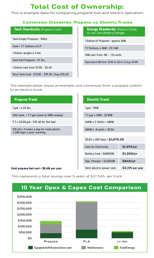

Evaluating the Pros & Cons of Propane VS Electric Forklifts
Propane forklift pros:
  • Good for extreme temperatures or rough surfaces
  • Consistent power throughout the shift
  • Continuous operation: when the tank empties, simply replace with a full one
  • Fuel can be available in remote locations
  • Low upfront cost
Propane forklift cons:
  • Non-renewable fossil fuel
  • Can’t be used for certain applications
  • Price fluctuations and fuel availability
  • Higher long term operating costs
  • Noisier than electric forklifts
  • Reduced field of vision and less maneuverable
  • Safety and spill risks
  • Operator training
Electric forklift pros:
  • Cleaner, no emissions and quiet
  • Safe for food and medical applications
  • Good for narrow aisle applications
  • Lower cost of ownership
  • Fewer moving parts
  • Require less maintenance
Electric forklift cons:
  • Higher upfront cost
  • Most electric forklifts aren’t designed for outdoor use
  • Battery charging time requirements
  • Must be charged in a specific location
