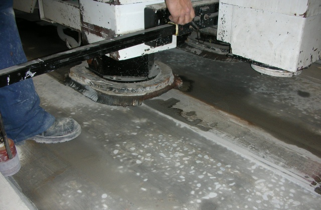

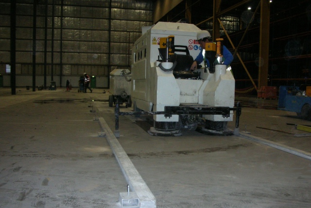

In June, the CoGri Group were awarded the contract to upgrade 1980 linear meters of aisle way by whole aisle width grinding to comply with the requirements of DIN 15185 for lift heights greater than 6 meters. Two Laser Grinders® were mobilised for the project, one from the UK and one from Singapore. The first Laser Grinder® arrived and grinding started in early August.
Transit for the second Laser Grinder® from the UK took longer than expected due to a change in the shipping schedule. The CoGri team adopted to reduce potential lost time by working the Singapore Laser Grinders® in double shifts. The shipping delay was not the only obstacle the team encountered. Those Aussie's can build a tough floor; a big chunk of the warehouse was post tensioned and topped with a metallic dryshake. Grinding was hard going!!
Finally the UK machine arrived on site. A third team mobilised to site to help drag meters out of the unwilling floor. In late October, 12 weeks after starting and just ahead of the racking team, the CoGri Group completed upgrading all 22 aisles each of which measured 95m long.
CoGri touched base with Graham Pinney, Goodman's Director of property and he commented, "We haven't heard of any issues from IKEA in relation to the aisle grinding which is great and overall we seem to have a very satisfied customer."
This project was the first Laser Grinding job in Australia for the CoGri Group. The patented Laser Grinder® can economically upgrade wheel path floor tolerances for 3 or 4 wheels Material Handling Equipment (MHE) and for maximum flexibility the whole aisle width can be upgraded to suit multiple MHE platforms working in the aisle. Floors can be upgraded to meet DIN, TR34 or ACI tolerances for VNA floors.
