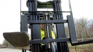

The mast seems to be in the way, but the blind spot is limited to just 26cm up to a height of two meters.

The designers have taken great care with optimizing visibility, which is very good, both next to and, through the mast, as well as over the dashboard and counterweight. The test truck has a three-part mast with free lifting and a total lift height of 4,750mm. No sideshift is fitted, and there is a small blind spot of just 26cm (incl. backrest) for a 2 meter total lift, partly thanks to the sleek carriage. The mast of the test truck could be more rigid when handling heavy loads at high lift heights.
