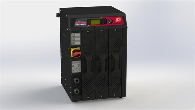

3 bay Raptor™ rapid charger by Douglas Battery™
Introducing the Raptor Rapid Charger by Douglas Battery
The Raptor rapid charger by Douglas Battery meets these criteria and more. The Raptor rapid charger can be used whenever a full or partial charge is needed and returns batteries to a full state of charge three to five times faster than conventional chargers.
By charging during normal shift breaks and forklift downtimes, battery changes can be virtually eliminated, avoiding productivity downtime and ultimately reducing operating costs.
Available for both wall and floor mounting, the modular configuration of the Raptor rapid charger provides the flexibility to maintain optimum efficiency at all times. If a module faults, the charger bypasses the module in order for charging to continue to keep operations productive.
In addition, the charger returns batteries to a full state of charge without generating excess heat and protecting the battery from damage due to excessive heat.
The Raptor rapid charger is compatible with the Douglas DataTrac battery monitoring system, which collects data about the battery's usage, charge return, water level, temperature and equalization.
The Douglas Battery network of manufacturer's representatives and service technicians stand ready to assist you and help keep your operation running smoothly with 24/7 emergency service, if needed.
