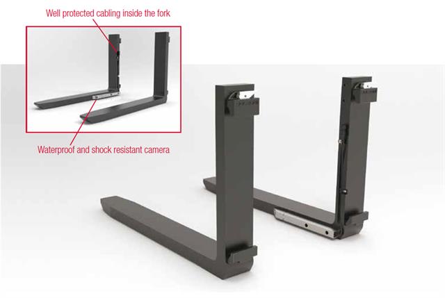

Easy-FORKS with camera fitted on the inner right fork side.
Fork mounted side camera
Thanks to the camera position, the driver can have a clear view on both forks, with a horizontal 52-degrees viewing angle, while maintaining the correct ergonomic position on the seat.
Camera images are displayed on a 7 inch. monitor installed inside the driver cabin. The connection between camera and monitor can be wireless (standard) or through a reinforced cable and cable reel. Easy-FORK are factory and aftersales solutions, available in customized and adapted configurations (cable reel as option).

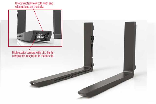

Easy-FORKS with camera fitted in the right fork inner tip.
Fork mounted tip camera
This type of solution allows the complete visibility upfront even when the load is on the forks. The robust IR camera has triple LED lights and is completely integrated in the fork tip. The connection cable remains inside the blade. By means of the led lights, the loading is made safe even in low light conditions.
Thanks to the camera position, the driver can have a clear view on the area, with a horizontal 52-degrees viewing angle, while maintaining the correct ergonomic position on the seat.
As for the lateral camera fork version, camera images are displayed on a 7 inch monitor installed inside the driver cabin. The connection between camera and monitor can be wireless or through a reinforced cable and cable-reel.
The Easy-FORK Vision Systems range includes the Side fork camera, the Tip fork camera, and a modular solution to be installed on the fork carriage, including Front camera and laser, which is under development.

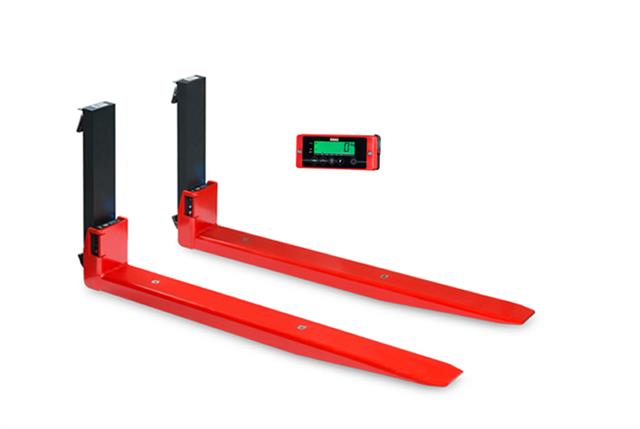

The installation of the RAVAS scale forks iFORKS-32 on the forklift truck takes 5 minutes.
Forklift Truck Scales: iFORKS-32
Installed in minutes, scale forks are used to directly weigh loads during the transportation through forklift truck and to keep track of the load weight data.
These are powered by compact Lithium ion battery packs, without cabling, and have all weighing components well hidden below and behind the fork shoe.
The high accuracy weighing is obtained thanks to the automatic compensation of the mast tilt. This function automatically corrects weight errors that occur when the mast tilts and the forks are not in horizontal position.
Finally, the weighing data are transferred via integrated Bluetooth. Thanks to the RAVAS WeightsApp, available on Google Play and App store, the smartphone or tablet act as a remote display and remote control for the scale.
"This high technology RAVAS product has been distributed by BOLZONI since August 2020," says Lorenzo Masoni, Bolzoni Group Fork Product Manager, "and we highly recommend this product in combination with the fork positioner."

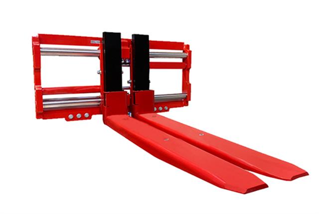

The RAVAS scale forks are easy to install on the  Bolzoni Auramo and Meyer fork positioners. Here fitted on a MEYER 6-2504 shaft guided model.
