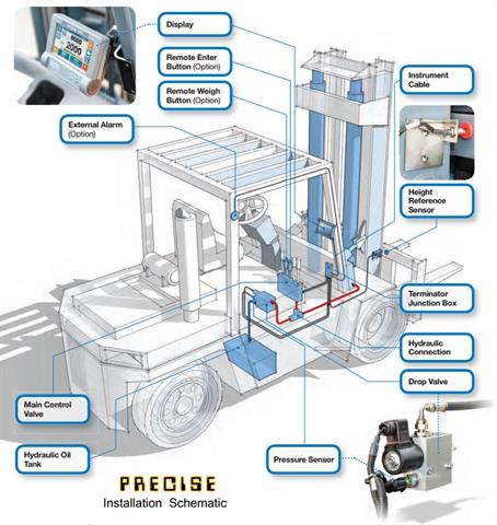

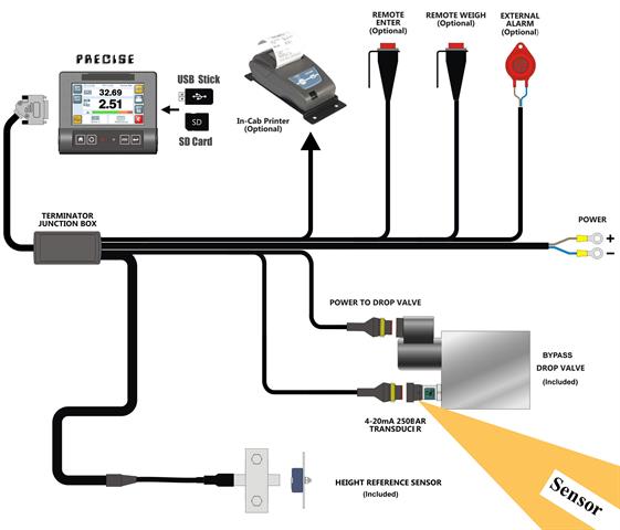

PRECISE is a new generation utilizing color touchscreen technology and a solenoid operated bypass module to produce such high accuracy. When an operator wants to weigh a load, he raises it to the level of the magnetic sensor which beeps alerting him to start the weighing process. Hydraulic fluid under pressure now bypasses through the module past the sensor where it samples hundreds of pressure readings. This process takes out most of the pressure inaccuracy associated with a single reading conventional hydraulic scale-providing accuracy nearly to that of a load cell sensor----at half the cost.

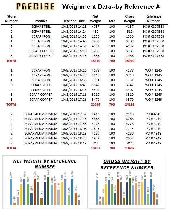

This instrument also allows the user to name up to 100 different channels (like aluminum scrap, XYZ Inc, etc) and to totalize each channels gross weight, tare (container weight) and net weight. Additionally an operator can type in a reference to each weighment (like PO#, invoice#, customer name, etc). Each channel stores up to 1400 events with independent IDs entered for each weighment. Users can remove the weighing data via a USB stick or by removing the SD memory card. Weighing event log data is time and date stamped and can be exported to an Excel spreadsheet where the data can be manipulated into reports, graphs and charts.

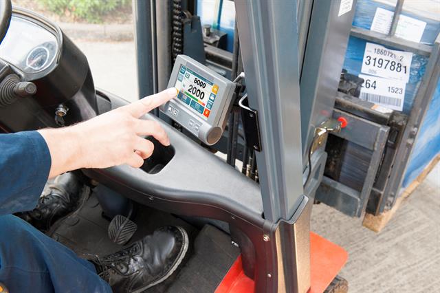

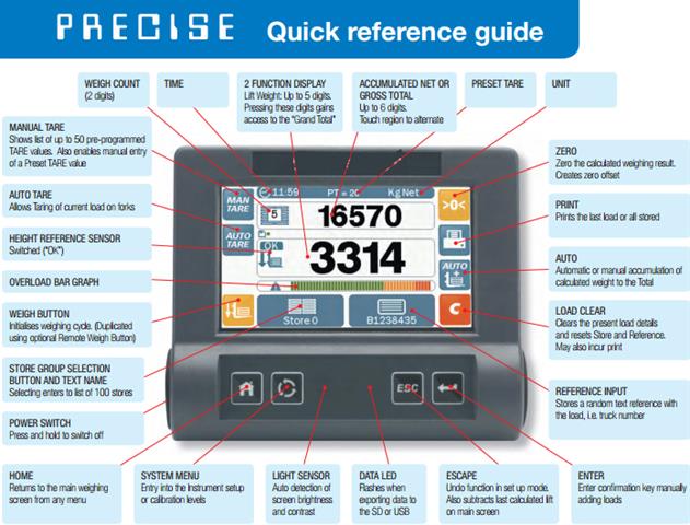

The device's 4.3" color LCD touchscreen display is very user friendly with easy intuitive control by simple touch commands on the screen. It is programmable in Lbs or Kgs. The device is water resistant and designed for tough industrial applications and weather extremes.

When a load is picked and before the weighing process begins, a horizontal line on the display gives the operator a "quick reference" as to the loads % of full capacity of the forklift. When the load picked is above a preprogrammed % threshold of full capacity---the unit will warn the operator and if overload continues set off an external siren alarm. It stores time and date of the last 10 overload events in the memory log.

  • Driver lifts load to "weighing height" ---device beeps when sensor detects magnet at weighing height.
  • Driver presses "read" button, solenoid opens manifold valve, load is lowered for programmable # seconds (typically about 5 seconds and forks drop about 16")
  • Alternatively driver can begin weighing process by pressing optional external thumb switch button mounted to hydraulic lever.
  • Fluid under pressure in manifold by-pass is "read" 150 times and pressure is averaged for much higher accuracy
  • Accurate weight of load just picked is displayed on display screen
  • In programmable # seconds---this load moves to total with cumulative weight above on display
  • If "tare" weights are involved, device can display both net load weights (in black) and gross load weights (in red) for both individual and cumulative load weights
