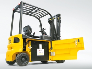

Forklift batteries are extremely heavy. PHOTO OM Carrelli Elevatori

  1. Forklift batteries expose workers to dangerous chemicals. Lead-acid and nickel-iron rechargeable batteries contain corrosive chemicals, which harm skin if a worker is not wearing personal protective equipment (PPE). Gloves, aprons, and face and eye protection are essential when handling batteries. Employees should also know how to properly clean up chemical spills.
  2. OSHA requires businesses with battery-operated forklifts to install eyewash stations and showers. Businesses must provide an eyewash station and, in some cases, an emergency shower within a 10-second reach of battery-operated forklifts. This helps minimise the impact of injuries caused by battery acid splashes or dust and flying debris. Organisations should partner with a safety provider that can maintain the eyewash station and regularly check fluid levels.
  3. Forklift batteries are extremely heavy and can weigh as much as 2,000 lb. (910 Kg). A forklift battery is much larger than a standard-sized battery. To ensure employees don't strain themselves while handling batteries, special equipment such as a battery cart should be used when recharging batteries. Protective footwear should also be worn by employees.

  7. Forklift batteries can emit toxic gases while charging. While charging, batteries release oxygen and hydrogen gases, which can be highly explosive if the workplace is not properly ventilated. Organisations should use fume hoods or exhaust fans to keep emissions from reaching volatile levels.
