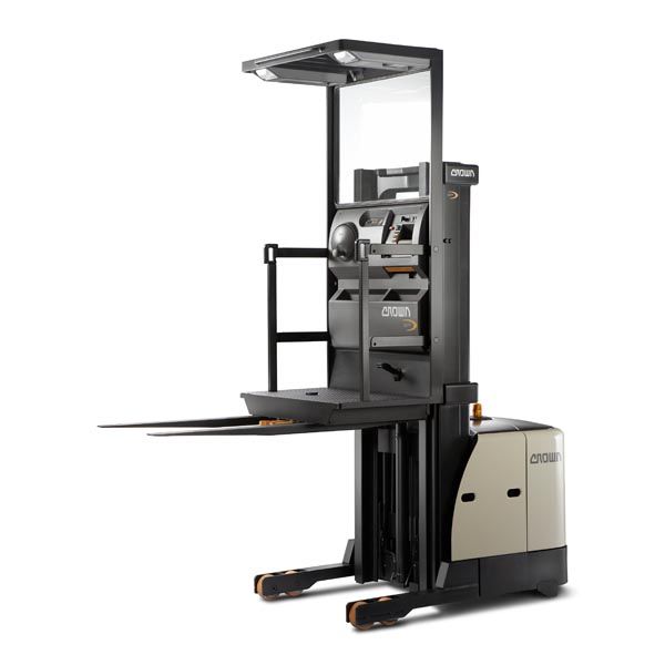

When I asked her how the operators' fall protection training was handled, she stared at me in silence for an uncomfortably long period, as the others in the tour group did, and finally asked why on earth forklift operators would need fall protection. I answered her by reporting what I spotted earlier, which was a fall protection harness connected and self-retracting lanyard (SRL) left attached to the anchor point of an order picker (see photo), presumably by the last operator to use it. This is a real no-no in the fall protection world, at least in my humble opinion. I won't go into detail on the conversation (or lack thereof) between myself and the tour guide from that point on. Suffice to say that fall protection training had not made it onto the agenda for their order picker operators.
However, this experience raised a larger issue; certain forklift operators at this particular location were not being fully trained for the type of equipment they were using.
An order picker is a unique machine that straddles the defining line between powered industrial trucks (forklifts) and aerial lifts; this hybrid machine is not only used as a materials handler, but as a personnel elevating device as well. This is because the platform on which the operator stands rises. Since the platform is not enclosed by guardrails, operators must use a personal fall protection system and the popular choice is a full body harness connected to a self-retracting lanyard.
