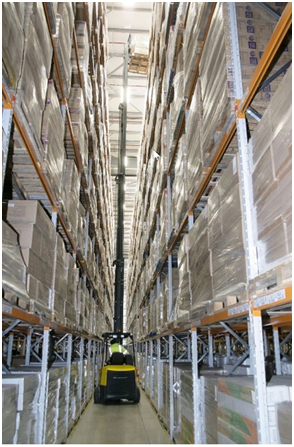

The landscape of materials handling is shifting toward smaller warehouses, higher racking, and narrower aisles. “Often referred to as 'micro-warehousing,' the rising costs of warehouse facilities and real estate are the main drivers of this trend,” Doug Pierce, Global Product Manager at Cascade says. “Building upwards is often more cost-effective than expanding outwards due to the high costs of building materials and land, especially in dense urban areas. Instead of relying on large distribution centers, companies are strategically positioning fulfillment centers to reduce delivery time and costs.”
In these smaller environments, higher racking and narrower aisles are required to maximize warehouse utilization, so the role of innovative forks, attachments, and mast solutions is crucial. "As the industry evolves, Cascade remains committed to providing cutting-edge products that address the unique challenges of narrow aisle warehousing,” Doug says. “Our focus is on enhancing efficiency, reducing costs, and seamlessly integrating advanced technologies to meet the evolving needs of our customers.”

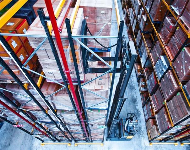

Cascade’s Trilateral Head is a traversing and swiveling fork system, allowing operators to retrieve pallets from either side of a narrow aisle with the forklift at a 90º angle to the load. This considerably reduces aisle width requirements, even when combined with a standard forklift. The Trilateral design also has 180º head rotation, making it a productive choice for any palletized load.

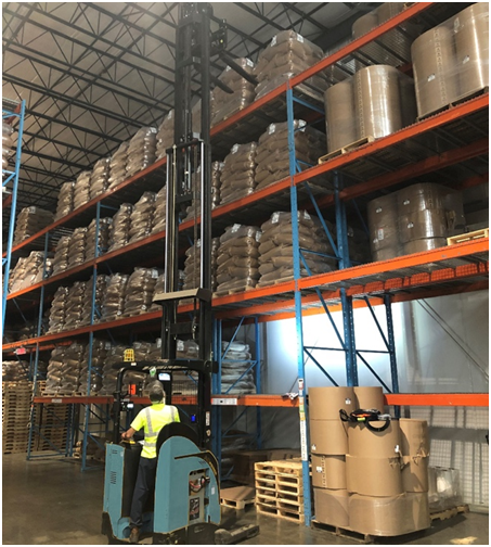

Recently, a customer with a narrow aisle warehouse required a custom solution for the front end of their AGV to allow for fast picking and depositing of loads. Lift-Tek Elecar, a division of Cascade, bundled their mast with a hybrid Cascade Trilateral Head. Combined with the Trilateral Head, this 3-stage mast can reach lifting heights of up to 12 meters/39 feet, perfect for high-racking warehouses. The Trilateral Head allows the forks to turn left or right 90º, letting automated trucks manipulate a pallet on either side of the aisle. Manufactured as a hybrid attachment, the custom Trilateral Head has hydraulic and electric functionality. Electric sideshifting and fork rotation are complemented by sensors that assist with speed and acceleration control for even more accurate load handling in very tight warehouse environments.
