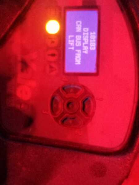

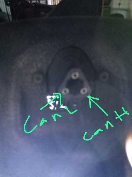

HI ,I am having problems connecting to a yale erc040 c883 model with yale 5.3 software and ifak cable. The forklift throws CAN codes and service tool shows no truck found when trying.CAN h and L wires show 58 ohms when truck is off but goes to 0 when turned on.I can connect to a propane c910 no problem and also hyster elect. Did anybody come across this problem before?
