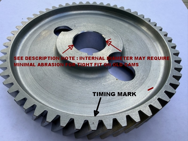

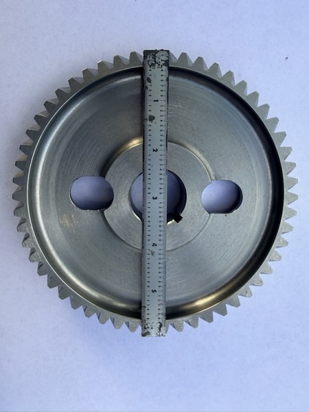

we had 10 gears run by a specialist reverse engineering company gear manufacturer in USA. Listed the gears on ebay.
all gears made from steel with timing marks and proper mesh etc.
https://www.ebay.com/itm/326837070269
cost a bunch to get them done but got our forklift FG103 fixed and also one other one locally. i would have hated to scrap this lift and cost of replacement for what we do would have been awful.
hope this helps someone in need.
