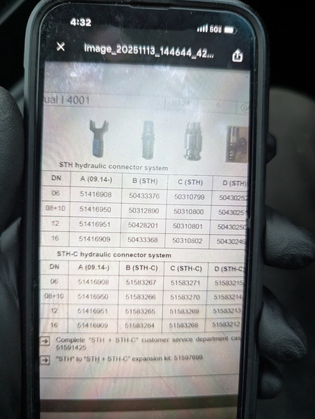

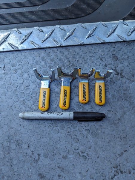

Here the photo of tools quick disconnect tools if your talking about a Jungheinrich truck.
  • Posted 12 Oct 2025 06:55
  • By Rob1708
  • joined 12 Oct'25 - 2 messages
  • Ohio, United States

If it's the same as the ETV320 then there should be a flange on the hose fitting. To remove push down on the flange and pull the hose up to release it for the block
  • Posted 13 Jul 2011 22:11
  • By Roibeard
  • joined 2 Mar'10 - 335 messages
  • Dublin, Ireland
