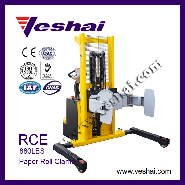

Veshai's RCE series is an economical model for small printers to handle small paper rolls, or for other applications such as drum or tube handling. It is designed with double-length clamps. The clamps always hold objects in the middle of rotating centre. It rotates a full 360 degrees.
The following are the main specifications of the clamp:
Model No. Load Cap. Openning Size Rotating
RCE-40/07 400 kg 350 mm - 750 mm 360 degree
RCE-40/09 400 kg 400 mm - 950 mm 360 degree
RCE series of rotating clamp can be mounted on a Veshai stacker such as semi-electric, walkie stacker and counterbalance stacker for choose. All the attachments should be factory mounted with all the control systems ready for use.

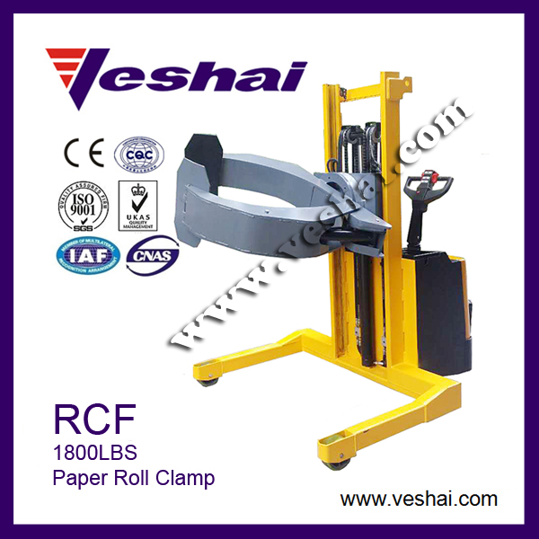

RCF series of clamp is a modified economical model based on the standard industrial clamp with the same functions for small printers to handle standard size of paper rolls. As it is factory mounted onto a walkie stacker, all the hydraulic control systems have been upgraded and adjusted for real application. Just by simply pushing a button, you can clamp, lift, rotating and move loads..
RCF series of clamp can be mounted on a Veshai standard walkie and counterbalance stacker, or onto standard electric forklift trucks.
The following is the main data of the clamp:
Model No. Load Cap. Opening Size Rotating
RCF-060/11 600 kg 450 - 1,150mm 360 degrees
RCF-060/13 600 kg 500 - 1,300mm 360 degrees
The following is the main data of the walkie stacker:
  1. Model : WS-130/16
  2. Load Cap. : 1,300 kg
  3. Lift H. : 1,600 mm (up to 3,000 mm option)
  4. Drive Motor : 24V/1.2 kw
  5. Hy. Motor : 24V/2.0 kw
  6. Battery : 24V/160 A or 24V/210 A option
  7. Charger : 24V/20A or 24V/30A

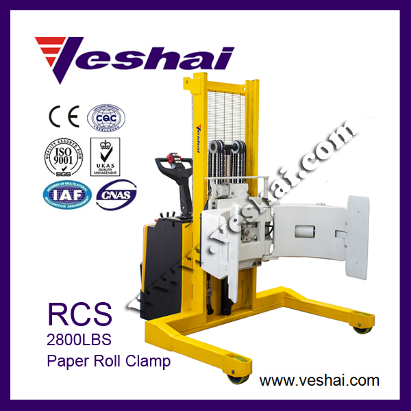

RCS series is standard industrial clamp mounted onto a walkie stacker. The truck's hydraulic systems have been upgraded for real application. It could be mounted on walker stacker with straddle legs or Veshai WSC series counterbalance stacker, with all the control systems ready for use.
RCS-130/11 1,300 kg 330 mm -1,150 mm 360 degrees
RCS-120/13 1,200 kg 410 mm - 1,300 mm 360 degrees
RCS-110/15 1,100 kg 450 mm - 1,500 mm 360 degrees
