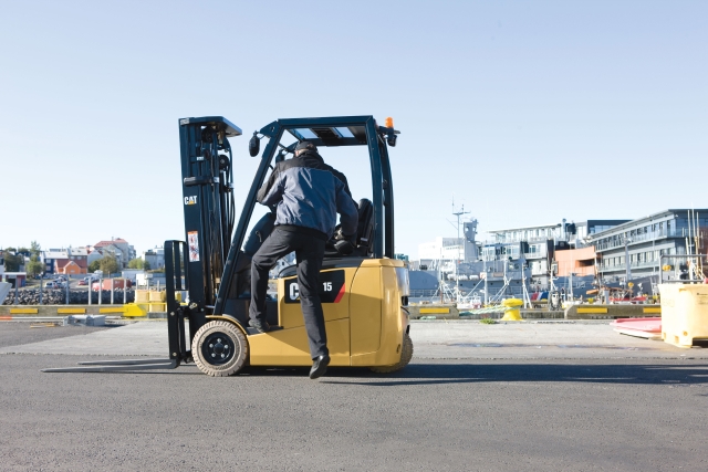

Low step provides less leg strain in applications with repetitive on-off access
