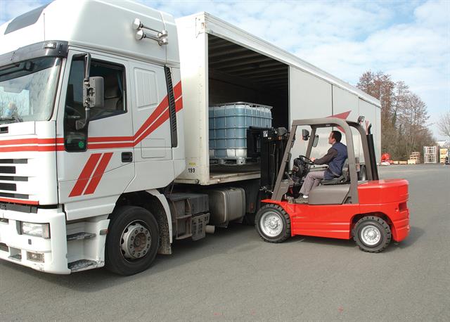

However, while they can specify their requirements, they should not be allowed in the loading area and must remain in a safe position while the forklift is in operation. Trying to help the process along either by holding back a curtain, steadying a load or directing from alongside puts them in real danger should a load be lost or the operator lose sight of them. And the serious injuries caused are almost always avoidable, because the pedestrian should never be in the operating area in the first place.

In recent years, one UK company was fined GBP1.2 million (USD1.65 million) after a HGV driver was fatally crushed when an overloaded forklift truck overturned. The resulting investigation found that the forklift had been unloading a 2.2 T load (42% over its maximum operational capacity), causing the truck to tip. It also found that there was no procedure in place to keep pedestrians a safe distance from loading/unloading operations.
