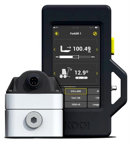

Meijer Handling Solutions introduced its KOOI®ReachControl; a system that includes a flowmeter (base unit 100x80x60 mm and an app to operate the system. This flowmeter can detect the amount of oil flowing through the reach forks. Specially developed software can be read using an app that is compatible with standard Android or iOS smartphones. The more extensive version of the KOOI® ReachControl features the ability to stop the outer sleeves at certain set lengths (at least 8 pre-sets).
Customers can enter the variables themselves and allocate a specific name to each setting. The system can be mounted on any telescopic fork as no modifications to the reach forks are required.
Without the automatic stop function, the system can be rapidly installed and information is transmitted by means of a Bluetooth® signal.
The auto-stop system features a special valve. In addition, a power supply is required because otherwise the battery in the KOOI® ReachControl would run down too quickly.
Although the app can be downloaded to any modern smartphone (iOS/Android), Meijer Handling Solutions recommends purchasing the specially developed 5" colour monitor because this can be connected to an external power supply and features a sturdy casing.
