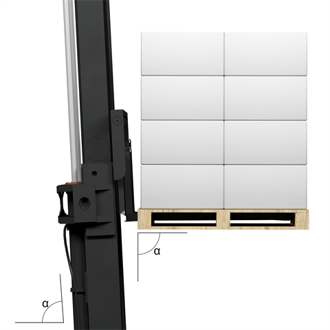

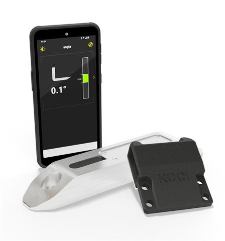

KOOI®Deflection system is a smart device that helps the forklift driver to level the forks horizontally. It is extremely useful for applications such as double-deep pallet storage. If a load is moved forward with a reach attachment like telescopic forks or a pantograph, it will show the entire tilt. Means, it includes the deflection of the attachment, mast and even the compression of the tires.
The forklift driver often has no idea how much this deflection is because this operation takes place out of sight of the driver. The sensor in the KOOI®Deflection system informs the driver how much deflection must be compensated by the tilting function of the forklift (mast or fork carriage tilt). In this way a safe working method is created and the load remains horizontal on the pallet, thereby preventing damage to pallets, rack and/or decking material. The tilt indicator can also help improve handling cycle time by allowing the lift truck operator to work faster as the operator always know if the forks are level prior to entering into the pallet.
KOOI®Deflection system is a small sensor which is mounted completely inside the nose of the telescopic forks. Because it is completely enclosed in the front of the KOOI®ReachForks, the sensor cannot be damaged and shows the maximum deflection. The sensor works via Bluetooth® and can easily be replaced if necessary.
A deflection sensor is also available to be mounted on the side of standard lift truck forks.
