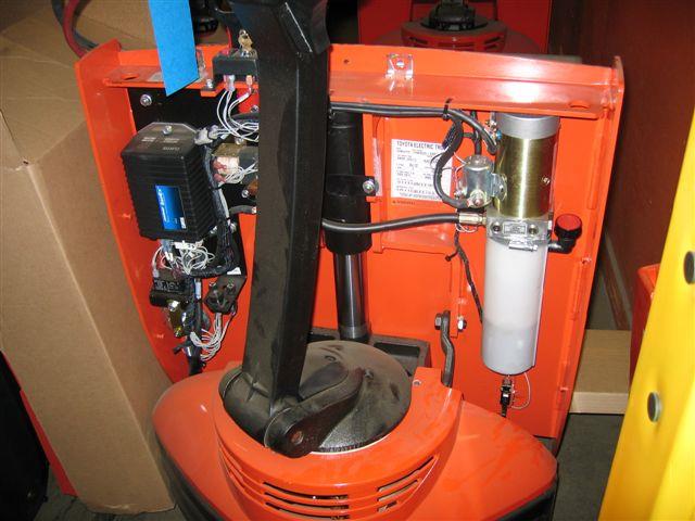

The hydraulic pressure transducer electric pallet truck check weighing system, ED2-EPT SkidWeigh Series is an economical alternative to the electronic load cell based pallet truck weighing scale.
This heavy duty, universal check weighing system is ideal for aftermarket retrofit to all kinds of "Electric Walkie Pallet Trucks" at either customer or forklift dealer locations.
The digital indicator compact design fits easily on the limited vehicle dashboard space. The simple installation of the hydraulic pressure transducer into the lifting circuit, utilizing IVDT's software will provide a fully automatic check weighing cycle, with no operator input required.
Typical installation time is less than two hours!
This model is suitable when the weighing accuracy of +/- 01%, as required for the "Legal for Trade" load cell based systems is not the primary factor; but the overall check weighing accuracy of +/- 1 to 3% of vehicle lifting capacity is acceptable to the operation.
ED2-EPT on an Electric Walkie Pallet Truck
This cost effective way to purchase and maintain an "Electric Walkie Pallet Truck" check weighing system will operate in the harsh work environment including refrigerated and freezer facilities.
