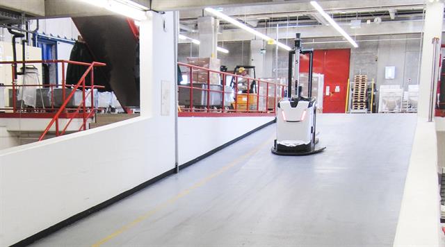

Special ramp for the AGVs
The specialty of the Seeberger production facilities is a ramp with a 9 % angle, and the AGVs use the ramp to move goods. The ramp floor is covered with a special coating, for more effective friction and for optimal breaking power.
Rocla and Seeberger developed a special detection system for the AGVs to help them to move on the ramp. The system, which slows the trucks down on the ramp, uses a magnetic switch which works through magnetic molding built in the floor. This system also reassures that the AGVs don't drive too fast on the ramp.
