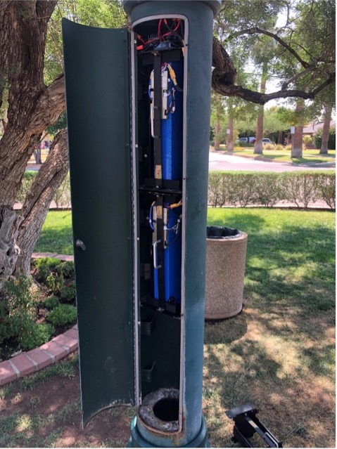

A good example of the use of the HigherWire solution is through the pilot project with the City of Phoenix.
“Here at the city, we want to be supporters of circular economy entrepreneurs helping our region transition from the linear economy and keep waste out of the landfill,” says Amanda Jordan, Circular Economy project manager for the City of Phoenix.
Jordan is partnering with Higherwire on a pilot project to use remanufactured lithium batteries for solar panel energy storage to power lighting in South Mountain Park.
The pilot kicked off on June 9, 2023.
The major concern has always been the batteries’ resistance to Arizona heat. “The positive outcome of this project will pave the road to the mass usage of second-life lithium cells as energy storage for the renewables (in Arizona).”
This is where the story of OneCharge demo battery ends. The lithium cells used in a forklift at the fruit packaging facility ended up in the energy storage for a solar array and are expected to work reliably for another 10 years.

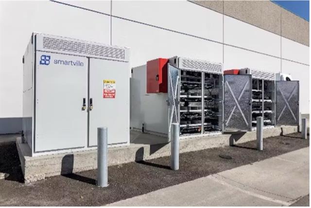

Repurposed lithium batteries were used in a 500 kWh solar energy storage unit in Sand Diego
The United States will surpass 1 million annual EV sales in 2023 and used EV batteries will provide used lithium cells for bigger-scale projects.
“We work to directly repurpose EV battery packs across a few different OEMs,” says Antoni Tong, chief executive officer at Smartville, which currently has multiple grid-interconnected projects under development. “[Repurposing used lithium batteries] supports domestic supply chain and manufacturing,” explains Tong.
Smartville’s customers include commercial and industrial applications sized from a few hundred kWh to a few MWh.
For example, UC San Diego uses its second life battery energy storage system to store solar energy from 200-kW rooftop solar to reduce demand on the local utility grid after sunset and avoid peak electricity rates. The 500-kWh system built by Smartville also provides up to 48 hours of emergency backup power.
